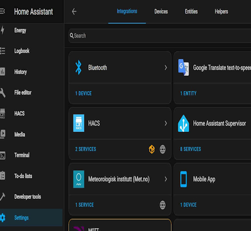

Check Mobile App Integration:
  • In Home Assistant, navigate to Settings > Devices & Services > Integrations.
  • Look for the Mobile App integration. This should automatically recognize your phone as a device.
  • This integration is by default enabled, unless you’ve disabled or removed the default_config: line from your configuration. If that is the case, the following example shows you how to enable this integration manually:

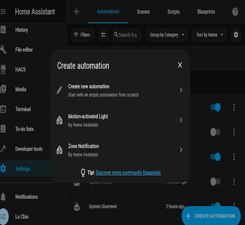

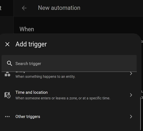

Go to settings   > automations & scenes     > create new automation
Press Add Trigger

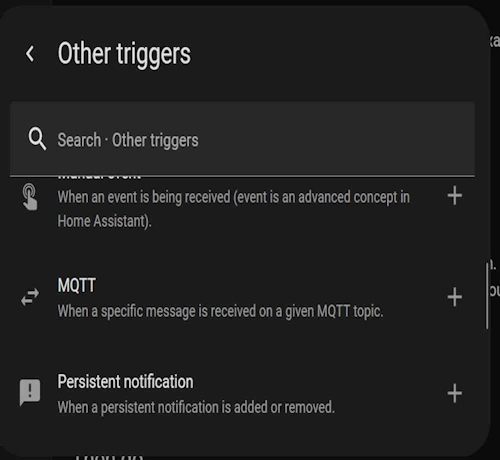

select Other Triggers

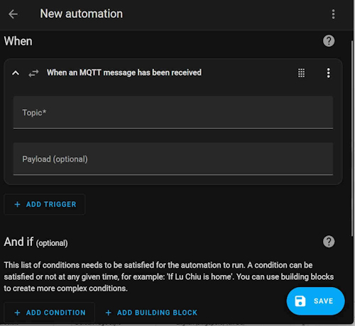

select MQTT

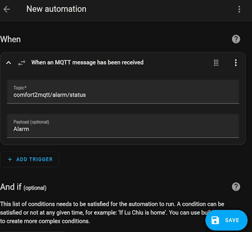

in Topic, chose a topic ie MQTT Topic Published (By Comfort)
  • comfort2mqtt/alarm - current MQTT Security Mode (disarmed, pending, armed_home, armed_away, armed_night, arm_vacation, triggered)
  • comfort2mqtt/alarm/online - \'1\' for online, \'0\' for offline
  • comfort2mqtt/alarm/message - Informational messages, e.g. the zone that triggered an alarm
  • comfort2mqtt/alarm/timer - countdown entry/exit timer in seconds when arming to away mode or entering. updates every second.
  • comfort2mqtt/alarm/status - Status of the alarm (Idle, Trouble, Alert, Alarm)
  • comfort2mqtt/alarm/bypass - List of Bypassed zones. EG. 1,3,5,7,9. \'0\' indicates no bypassed zones.
  • comfort2mqtt/alarm/LWT - Online or Offline text status
  • comfort2mqtt/alarm/refresh - Trigger a refresh of all objects. Used when a refresh of all object states are required.
  • comfort2mqtt/alarm/connected - Status of LAN Connection to Comfort. \'1\' when connected and logged in.
  • comfort2mqtt/alarm/doorbell - \'0\' for off/answered or \'1\' for on
  • comfort2mqtt/alarm/mode - Integer values for current Alarm Mode. 0 - 4 (Off, Away, Night, Day, Vacation), See Comfort M? or MD documentation.
Eg to select Alarm State = Alarm , enter topic = comfort2mqtt/alarm/status
Payload = Alarm
If the payload is left blank it means that any change in Alarm State will trigger the notification eg Idle, Trouble, Alert, Alarm

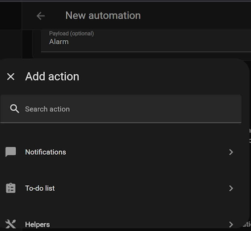

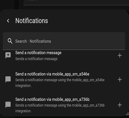

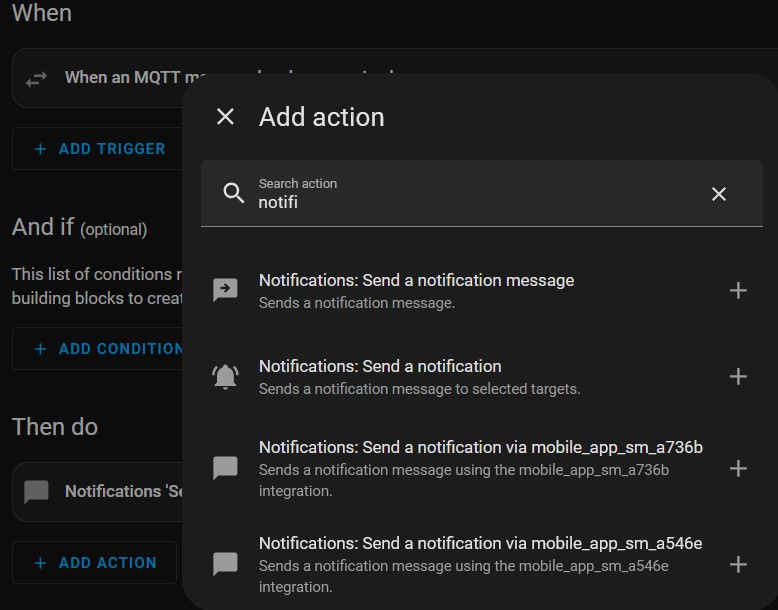

Select Then Do, and + Add Action
scroll down and select Notifications or enter notifications in the search  bar;
Look for Send a notification via mobile app and select the ID for the mobile device that has been added as a User
If more than 1 phone is required, add another action and select the next mobile device
Press Save
