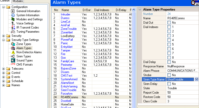

Sorry I waS mistaken
850 ms is the maximum sensitivity. Try that instead of 500 ms

Ok, I\'ve changed the sensitivity of the PA alarm type - when I change it to 50ms, if I tap the panic alarm button with a piece of plastic (doesn\'t conduct), it goes off every time I tap it.
When I change it to 850 ms and tap it, it will go off much less frequently - i really have to bang it.
I\'ve changed the PA unit already, so can\'t see why it would be a fault with the unit / contact / reed switch....could tapping it effect the resistors somehow? ie they are vibrating? I know that sounds daft!
So basically I have identified that tapping a PA button with a non-conducting tool sets it off, less often when sensitivity is lower.
What could it be causing it? It could be the 240v lighting cable near it, it could be another faulty PA unit (but what are the chances)?

Perhaps it could be a problem with the brand of PA buttons
Tapping on the button without activating it should not be causing it to activate
Increasing the sensitivity value should reduce the incidence of the false alarm according to what you have found
There is a way to increase the value further
There is an action found in Response Wizard in Inputs > Set Extended Sensitivity Count 1 to 5
This multiplies the sensitivity to a maximum 850 x 5
This response should be in the Zone Response
When you press the PA button you would expect it to be pressed for a few seconds
This should help reduce the false activation
