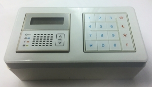

Berker has a 2gang surface mount backbox in their S1 range which is suitable for the KP06, for installations where flush mount is not possible.
Size 168 x 84 x 42 mm
Insertion Depth 37 mm
KP06 mounted in  the 2 gang surface mount backbox is shown below, with the FR2-EV-WH frame which covers the box completely
It is not as thin looking as the wallmounted KP06 but it may e needed in some installations
This is the link to the Berker backbox
http://www.berker.com/berker-online-catalogue/switch-ranges/berker-s.1/surface-mounted-housings/10429909/1024-5824.htm

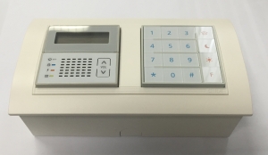

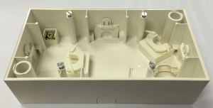

Here is another surface mount backbox from Merten (Schneider) which is suitable for the KP06 White version. This has rounded corners compared to the Berker S1 which has sharp corners. They also have a Black bakbox which may match the KP06 Black
