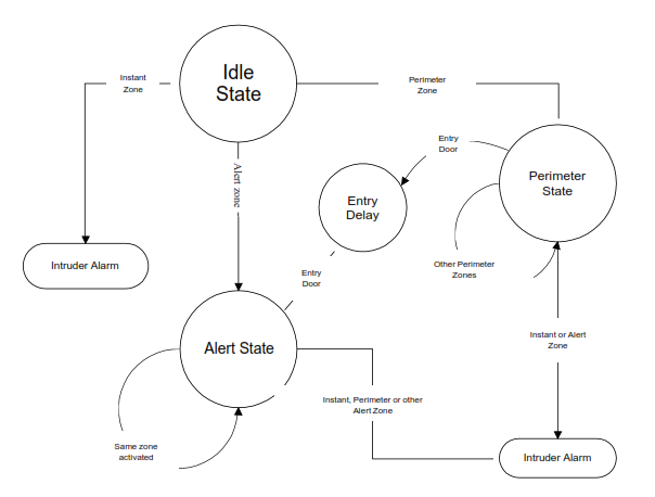

The default Response \"Entry Delay in Day Mode\" will work
If SecurityMode = DayMode Then
    Start EntryDelay
End If
Use this as the Zone Response for the Window
When the window is opened in Day Mode, it will start an entry delay, like the entry door and beep so you know you have to disarm
A Perimeter zone followed by Alert Zone  (or the reverse) will cause an intruder alarm
An Alert Zone followed by a different alert zone will cause an intruder alarm
Perimeter zones are meant for the perimeter area (or window)
Alert zones are meant for internal PIRs
So someone cross the perimeter will only cause an alarm if an Alert zone is detected
The flowchart shows how the system operates
